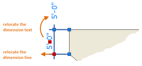

For simple adjustments to dimensions, nothing is faster than using grips.
In this example, you select the dimension to display its grips. Next, click the grip on the dimension text and drag it to a new location, or click one of the grips at the end of the dimension line and drag the dimension line.

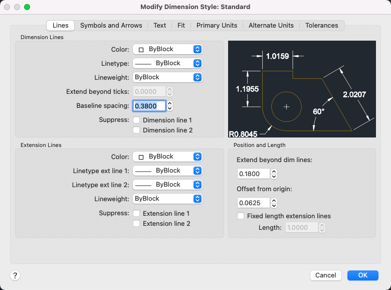

Dimension styles help establish and enforce drafting standards. There are many dimension variables that can be set with the DIMSTYLE command to control virtually every nuance of the appearance and behavior of dimensions. All these settings are stored in each dimension style.
The default dimension style is named either Standard (imperial) or ISO-25 (metric). It is assigned to all dimensions until you set another style as the current dimension style.
The current dimension style name, Hitchhiker in this case, is displayed in the drop-down list of the Properties Inspector when no objects are selected.
Use the Dimension Style Manager to create and modify dimension styles.
You can create dimension styles that match nearly any standard, but you will need to invest time to specify them completely. For this reason, you should save any dimension styles that you create in one or more drawing template files.
