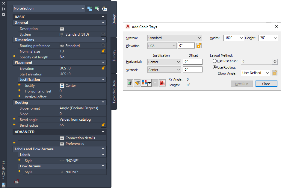

  1. In the Electrical workspace, click Home tabBuild panel. Then click Cable Tray Find or Conduit. Find
  2. For the remaining steps, use the Properties palette for conduit settings or the Add Cable Trays dialog box for cable tray settings, as shown next.
    Conduit* (left), cable tray (right)
    *Shows expanded properties including parallel routing mode

  4. Specify Routing Preference for Conduits from Properties palette > General > Dimensions > Routing Preference >
  5. Specify dimensions from the following locations:
    • For cable tray: In the Add Cable Trays dialog box, at Width and Height
    • For conduit: On the Properties palette, under Dimensions, at Nominal size
    • For conduit: Properties palette > Placement

    • For cable tray: In the Add Cable Trays dialog box under Use Routing, at Elbow Angle
    • For conduit: On the Properties palette, under Routing, at Bend angle
