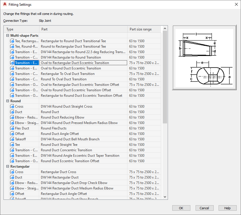

To override a default fitting
Fitting Settings dialog box
The Fitting Settings worksheet shows the current Connection Type, and lists the available types and parts.
The overridden part is automatically inserted into the layout.
The override is removed after you end the DUCTADD command. The next time you run DUCTADD, the default part from the routing preference is used once again.
