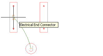

Wiring a junction box to a light with electrical snaps

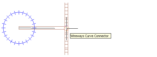

Connecting one cable tray to another with wire ways snaps
