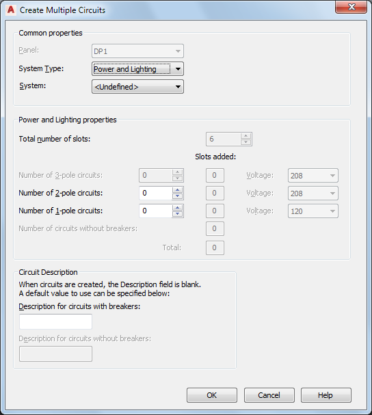

When you add a panel, you can create one or more circuits assigned to the panel at the same time. Alternatively, you can use Circuit Manager to create the circuits before or after you add panels or devices.

Name, enter a unique name for the panel.
| If the system type is… | then… |
| Power and Lighting | Do the following:
| General or Other | for Number of circuits, enter the number of circuits to create. |

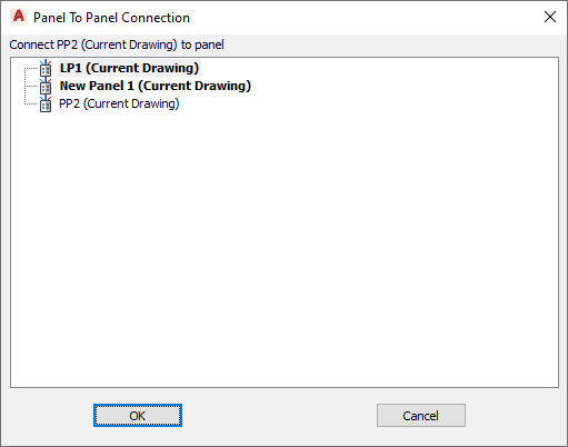

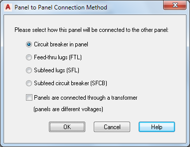

| No | do the following:
| If you select… | then… |
| Circuit breaker in panel | the panel is added as a subfed panel to an existing circuit in the linked panel. |
| Feed-thru lugs | the panel is added as a subfed panel to a feed-thru lug in the linked panel. |
| Subfeed lugs | the panel will be added as a subfed panel to a subfeed lug circuit in the linked panel. |
| Subfeed breaker | the panel will be added as a subfeed panel to a subfeed breaker circuit in the linked panel. |
| Panels are connected through a transformer (panels are different voltages) | the panel will be connected through a transformer when panels are of different voltages. |
