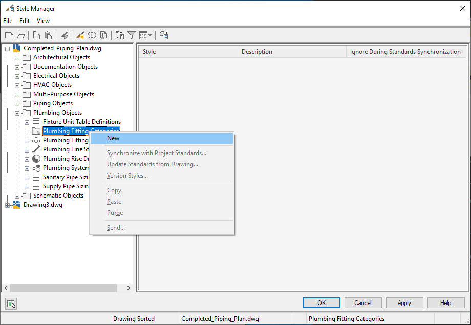

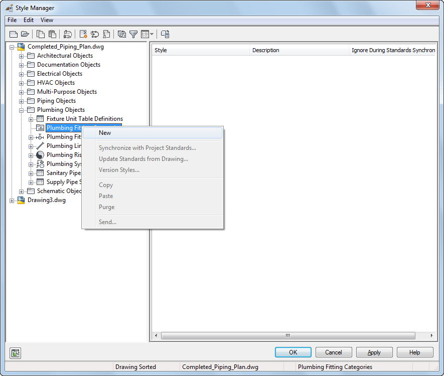

  1. Click Manage tab Style & Display panel Style Manager .
  2. Expand the specific Objects node in the left pane. In this example, select Plumbing Objects.
  3. Right-click the desired category — in this case, Plumbing Fitting Categories. Then click New.
  4. Enter a name for the new category, and press Enter.
