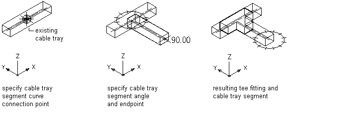

When you start a run at the end of a segment, the nearest valid connection point is not always the endpoint of a segment. You can form a valid connection at any point along the path of another run. In this case, the software inserts an appropriate fitting to connect the 2 runs.
Drawing a branch

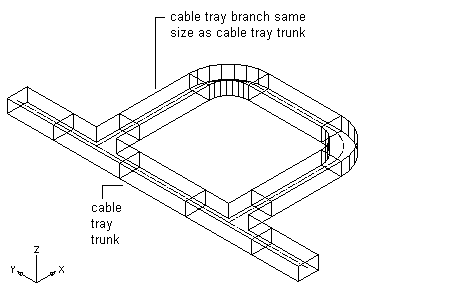

Connecting a cable tray run to a cable tray trunk that is the same size
To add a cable tray or conduit branch
