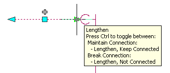

You can modify the length of schematic line segments using lengthen grips .Because the grips constrain a segment to its current angle, they are particularly useful for modifying the length of schematic line segments you have already placed.
When you use the lengthen grip on an end that is connected to another object, you must specify whether you want AutoCAD MEP 2025 toolset to maintain connectivity between the objects.
Unconnected schematic line segment
Connected schematic line segment
  1. Select the schematic line segment.
  2. Click the Lengthen grip on the end you want to modify.
  3. If the segment is connected to an object on the end you selected, specify whether and how to maintain connectivity:
    If you want to... then...
    maintain connectivity by adjusting only schematic fittings and segments, and retain the current locations of parts proceed to the next step.
    maintain connectivity by adjusting all objects, including parts press Ctrl.
    break connectivity press Ctrl.
