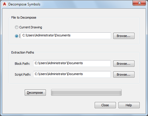

  1. Click Manage tab MEP Content panel Decompose Devices .
  2. In the Decompose Devices dialog box, for File to Decompose, then select the drawing (DWG file) that contains the device styles to convert:
    If you want to… then…
    convert the device styles in the current drawing open in AutoCAD MEP 2025 toolset click Current Drawing.
    convert the device styles in a drawing stored locally on your computer click the radio button beside the file path, click Browse, select the drawing file, and click Open.
  3. For Block, click Browse, and select the folder in which to place the drawings that contain the AutoCAD blocks used by the device style views. Click OK.
    If the selected folder already contains drawings, then during the conversion process, you will be prompted about overwriting drawings with the same name.
    Note: Like all AutoCAD® blocks, the blocks in the output drawings are stored in an invisible data area called the block definition table.
  4. For Script Path, click Browse, and select the file name of the device conversion script to create:
    create a new script in the Select File dialog box, specify the location for the new script, enter a name, and click Save.
    overwrite the contents of an existing script in the Select File dialog box, select the drawing, click Save, and then click Yes to confirm that the contents of the drawing can be overwritten.
  5. Click Decompose.
    The software converts the device styles into the blocks used by the style views and generates an associated script based on the style definitions.
