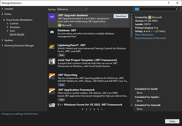

  1. Install the .NET Upgrade Assistant plugin.

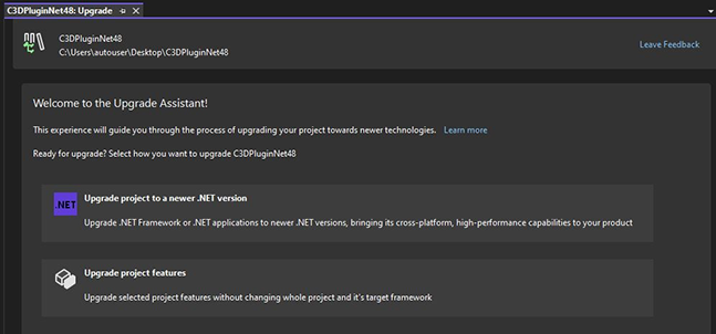

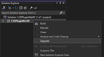

  2. Right-click on the project in the Solution Explorer window, and select Upgrade.
  3. Select Upgrade project to a newer .NET version.

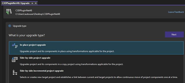

  4. Select your upgrade type.

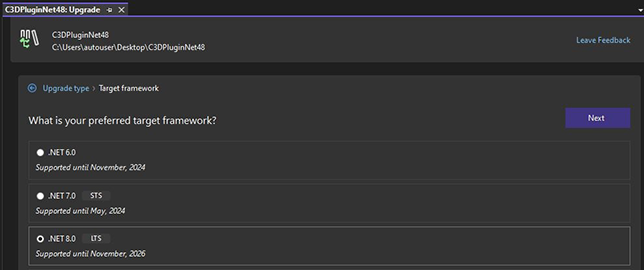

  5. Select .NET 8.0 as the project target framework.

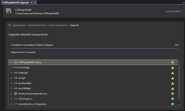

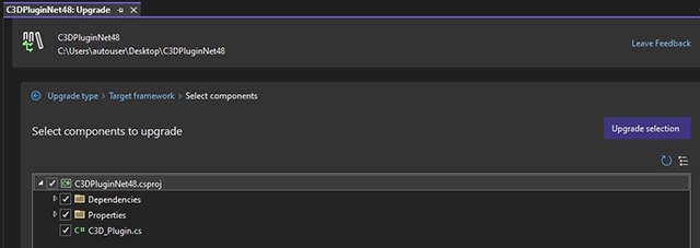

  6. Select components to upgrade and click the Upgrade selection button.
  7. Check the result.

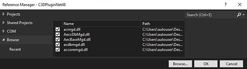

  8. Manually replace the reference DLLs with the .NET 8 version DLLs.
