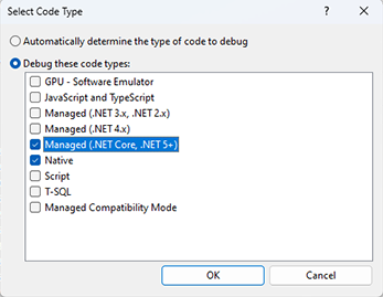

  1. In Visual Studio, select Debug Attach to Process (or press Ctrl+Alt+P) to open the Attach to Process dialog box.
  2. Select the code types. Choose both if you want to do the mixed debugging.
    • Managed(.NET Core, .NET 5+) for .NET Core codes debugging
    • Native - C/C++ for native code debugging
