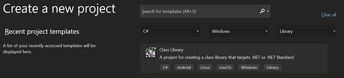

Create a New Class Library Solution and Project
Use C#, Windows, and Library to filter the Class Library that targets .NET or .NET Standard.

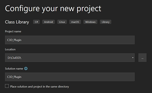

Configure the new project.

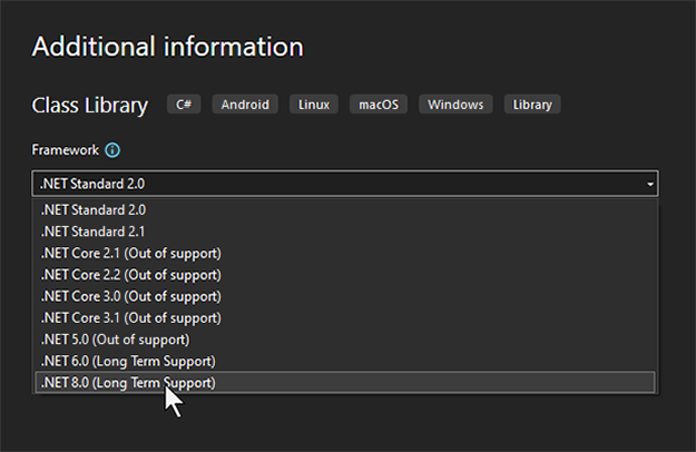

Set the target framework to .NET 8.0 and create the project.

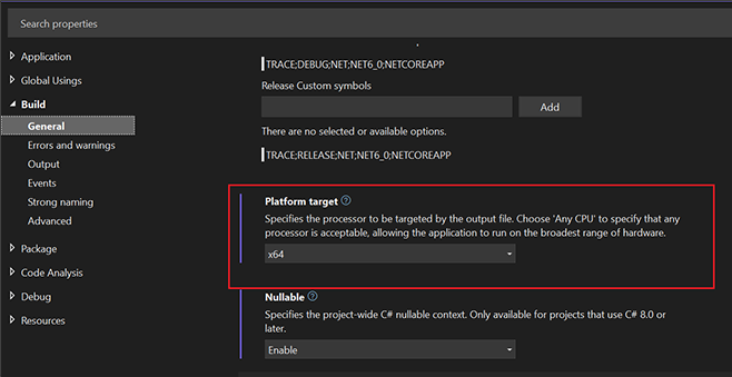

Set Build
General
Platform Target to x64.
