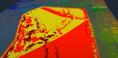

Visualization tools allow you to watch the optimization process in real-time. Using several visualization themes for the surface (violation, cut-fill, or elevation), or by watching the trends of the convergence plots, you can stop and change designs or let it run until a desired grading solution is found.If a solution is not possible, a best approximation is provided to your constraint requirements.

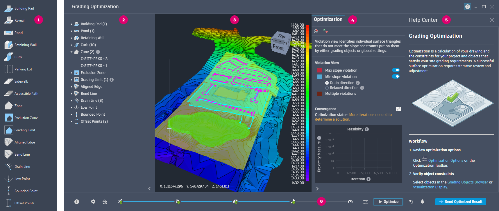

The following image shows the main elements of the Grading Optimization interface. It may appear slightly different depending on the software from which you are using the Grading Optimization tools.
Grading Object Tool Palette - This tool palette in Civil 3D allows you to tag drawing elements as grading objects for optimization. Each object listed contains default constraint data. You can right-click any object tool to edit the default values applied when used, or create additional customized objects.
Grading Objects Browser - This tree directory categorically displays each object tagged from the drawing. Selecting a grading object will display the currently specified constraints assigned to it.
Visualization Display - This is the viewing area for the optimized grading data. Several display themes are available to view the surface during and after optimization. The slide to the left of the display exaggerates the contours of the surface to help view subtle changes in elevation.
Optimization Toolbar - This bottom band of tools allows you to specify global constraints, mesh and triangle quality, visualization options, and convergence plotting views. Once everything is specified, click Optimize to begin the process.
Help Center - This panel provides in-context guidance as you work in Grading Optimization. Workflows, example drawings, and links to relevant learning content are also available.
Optimization Toolbar - This bottom array of tools allows you to specify global constraints, mesh and triangle quality, visualization options, and convergence plotting views. Once everything is specified, click Optimize to begin the process.

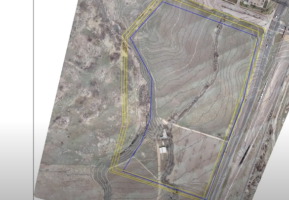

When using the grading optimization tool, you will first need an existing topography to build on.
Draw basic grading information onto the topography. This information could involve drawing the outline of the grading area or defining the low point of the grading model.

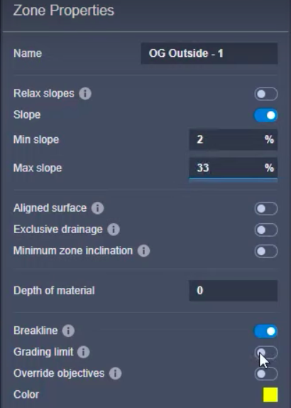

  4. When you have established the grading objects, you can edit the object. To edit the grading object, select the grading object in the drawing or by selecting it from the Grading Object Browser. With the Grading Objects window open, you can edit the properties of each object by right-clicking an object and selecting Properties.

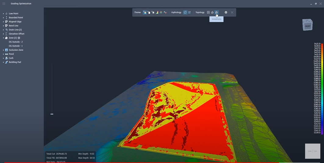

  7. You can view the optimization process by clicking the Visualization Toolbar icon at the bottom of the interface. The toolbar will display in the model space.
    From the visualization toolbar, you can choose from the visualization themes including Violations, Cut-Fill, and Elevation.
    While the tool runs, the number of violations should hit a minimum amount. If you are satisfied with the optimization you can stop the process and send the resulting surface to Civil 3D as its own TIN Surface.
    Additionally you can click Convergence Plots from the bottom Toolbar to view the optimization progress as it works within the established parameters.

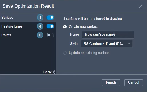

  8. To send the graded surface to Civil 3D, click the button Send Optimized Result button from the bottom toolbar. In Civil 3D, you should see a new window appear. The optimized surface can be transferred to the drawing as a new surface or it can update an existing surface.
    Name the optimization result and choose the style you wish to save the result.
