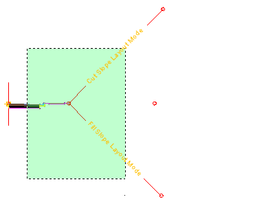

The viewport zooms to the assembly baseline, which looks like this:

The right lane subassembly is now attached to the assembly baseline.

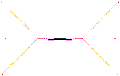

Mirror the subassemblies to the left of the baseline
The subassemblies are displayed on the left side of the assembly marker. The Mirror command creates a mirror image of the selected subassemblies. All the subassembly parameters, except for the Side parameter, are retained.
The parameters of the mirrored subassemblies are not dynamically linked. If you change a parameter value for a subassembly on one side of the assembly baseline, the change will not be applied to the opposite side.
