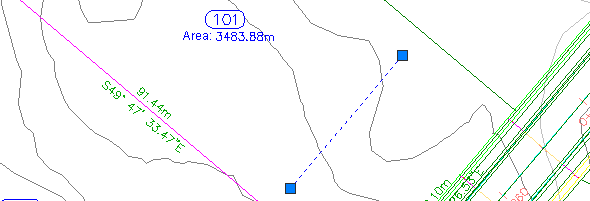

Edit the projected object elevation
In the AutoCAD Text Window, notice that the elevation values for the polyline vertices are approximately 38.
When you select the 3D polyline in the profile view, notice that the 3D polyline in plan view is highlighted.
 grip down toward the bottom of the profile view.
When you grip edit a projected feature line or 3D polyline, the corresponding elevation of the source object is adjusted.
