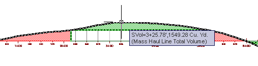

Notice that the highest point of the green free haul area is at station 3+25. This is the grade point, which is the point at which free haul transitions from cut to fill. Depending on the site conditions, grade points can be logical locations for dump sites or borrow pits, which can reduce or eliminate overhaul.
Notice that the tooltip displays the current station number (3+25) and volume (approximately 1500.00 Cu. Yd.).
This is the number of the station at the grade point for the volume above the balance line.
This is the approximate volume (1500.00 Cu.Yd.) at the grade point.
The cut volume above the balance line is entirely free haul. Notice that now there is a red, overhaul volume below the balance line. You will balance the fill volume in the following procedure.

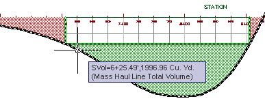

Notice that this is near the point at which the overhaul volume (in red) and the free haul volume (in green) meet the mass haul line. If you examine this station on the profile, you see that it is also a relatively flat section of the existing ground surface. Flat areas can also be good locations for dump sites and borrow pits.
Notice that the tooltip displays the current station number and volume, which is approximately 2000.00 Cu. Yd.
. Notice the lack of surface contours in the area around station 6+25. This indicates that the region is relatively flat.
This is the approximate volume value that you noted in Step 2.
The fill volume below the balance line is entirely free haul.
