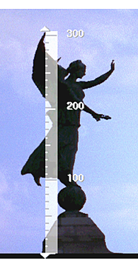

Enable to display the ruler in the scene area. Use the arrows at each extremity of the ruler to place the beginning and end of the ruler anywhere in your scene view.
Enable to define real unit measurements, such as feet, metres, or inches, instead of pixels. All camera distance or axes measurements thereafter use the defined scale.
Displays the length and measuring unit (feet, metres) to use in Action. When you enter a length, click Define again to apply the new scale to the ruler and all pertinent fields, such as position, rotation, and scale. Editable.
