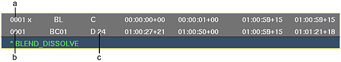

Dissolves in EDLs
Dissolves are represented in the EDL by two consecutive edits with the same event number. The first edit represents the outgoing shot of the dissolve and the second edit represents the incoming shot of the dissolve. The dissolve is listed in the Transition column of the second edit as D n (where n is the transition duration).
The Transition duration appears in the Transition entry of the second edit in the dissolve. The Start Location for the dissolve is also indicated in the Transition entry.
If the EDL was exported from Flame, the dissolve can be Centred, From Cut, or Up To Cut. The start location for the dissolve appears beside the Transition duration.
The following illustration is a typical dissolve in an EDL.
(a) Outgoing shot  (b) Incoming shot  (c) Transition duration  
If you change the Transition duration of a dissolve, the Source Out of the incoming shot changes by the same duration automatically.

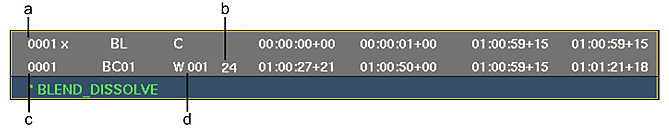

Wipes in EDLs
Wipes are represented in the EDL by two consecutive edits with the same event number. The first edit represents the outgoing shot of the wipe and the second edit represents the incoming shot of the wipe. The wipe is listed in the Transition column of the second edit as W n m (where n is the wipe code and m is the wipe duration).
The SMPTE wipe number appears in the Transition entry of the second edit in the wipe. The Start Location for the wipe is also indicated in the Transition entry. A wipe can be Centred, From Cut, or Up To Cut. The start location for the wipe appears beside the Transition duration. The following illustration is a typical wipe in an EDL.
(a) Outgoing shot  (b) Transition duration  (c) Incoming shot  (d) SMPTE wipe number  
If you add 500 to the SMPTE wipe number, the wipe is inverted during assembly. For example:
Wipe 002
Wipe 502
If you change the Transition duration of a wipe, the Source Out of the incoming shot automatically changes by the same duration.
