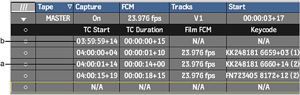

To slip the keycode for a given tape:
  1. In the Import EDL menu, from the Display group, enable View Tape List.
  2. If necessary, click the triangle on the left of the tape entry to expand its contents.
    Sequences of timecode on the tape are associated to keycode values. If no keycode is available from the telecine log(s) you loaded, N/A (not available) appears for the sequence.
    (a) Timecode start and duration defines sequence, with corresponding keycode  (b) Timecode without corresponding keycode  
