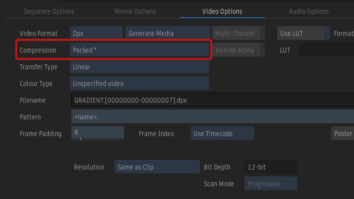

Link Media (Resolution): Creates links instead of new media for frames that are unedited, and with a destination resolution matching that of the source media files. Edited frames or frames with a different resolution from the source media files result in Flame writing new media files to disk. The resolution is set in the Resolution Presets box in the Media Export window; Same as Clip uses the resolution of the exported sequence, not the resolution of the source media.
Link Media (Bit Depth): Similar to the option Link Original Media available in previous versions (2018 and earlier). Creates links instead of new media for frames that are unedited, and with a destination resolution and bit depth matching that of the source media files. Edited frames or frames with a different resolution or bit depth from the source media files result in Flame writing new media files to disk. The bit depth is set in the Bit Depth box in the Media Export window.
Link Media (Compression): Creates links instead of new media for frames that are unedited, and with a destination resolution, bit depth, and compression matching that of the source media files. Edited frames or frames with a different resolution, bit depth, or compression from the source media files result in Flame writing new media files to disk.

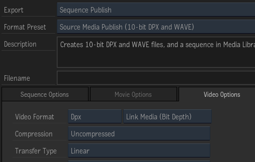

Simple Link Media (Bit Depth) example:
Import a sequence of 50 .dpx files, with a bit depth of 10-bit.
Of that sequence, you colour correct only the first 10 frames.
Export that sequence as a Sequence Publish, using the format preset Source Media Publish (10-bit DPX and WAVE). Notice how in the menu Video Options, the box Link Original Media is set to Link Media (Bit Depth).
The result of the export is 50 .dpx files:
The last 40 files are referenced, and because they were neither created nor moved, the export process was that much faster.
