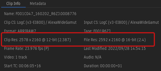

Select Full to use the full sensor resolution of the camera, and appears as the File Res in the Clip Info tab. Select Camera to use the cropped resolution set by the camera at capture, and appears as the Clip Res in the Clip Info tab.
