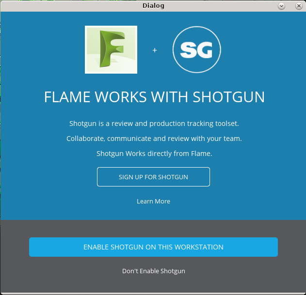

A ShotGrid dialog window appears after the first launch of a new project. Four options are given in the dialog window:
Should you change your mind about using ShotGrid after having selected an option from the ShotGrid dialog window, you can do so using the Flame Setup Utility. Selecting "Enable ShotGrid on this Workstation" or "Don't Enable ShotGrid" in the dialog window actually sets a ShotGrid Plugin token to "Enabled" or "Disabled" in the Flame Setup application. You can manually change the setting to "Enabled" if you want to enable the feature, "Disabled" if you want to disable it or "Prompt" if you want the original dialog window to appear at the next software launch.

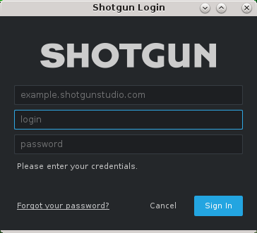

The ShotGrid Login window appears at software launch, where you can log onto your ShotGrid site directly from Flame.

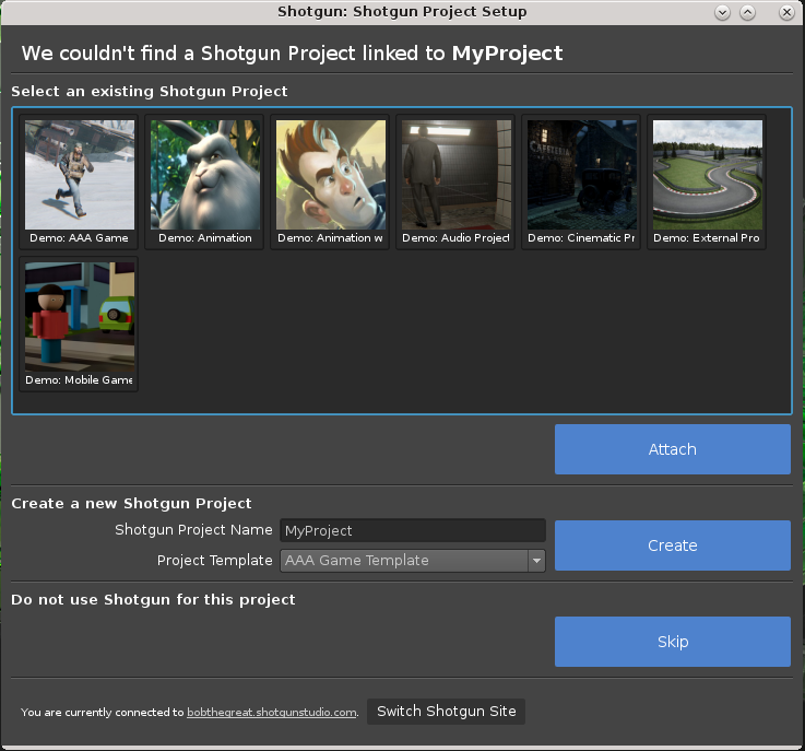

ShotGrid is able to interact with Flame projects by creating a corresponding ShotGrid project for each Flame project. To be able to use ShotGrid, the Flame project must be associated to its ShotGrid counterpart. A ShotGrid Project Setup window appears for every Flame project not already associated to a ShotGrid project.
Your options here are to:
You can also select a Project Template, if pertinent.

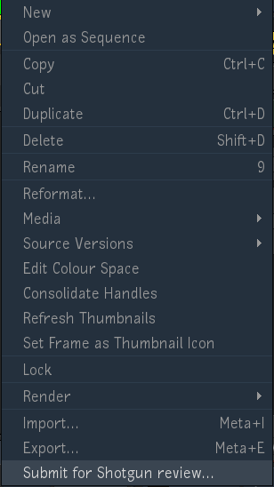

Once you’ve properly associated your Flame and ShotGrid projects, in Flame, a new option appears in the context menu of the selected media: Submit for ShotGrid Review.

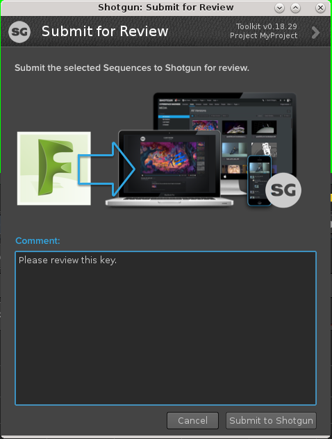

Selecting this option launches the ShotGrid Review window, into which you can add a comment. Clicking Submit uploads the current clip and the comment to the ShotGrid Project.

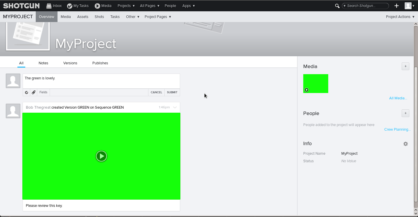

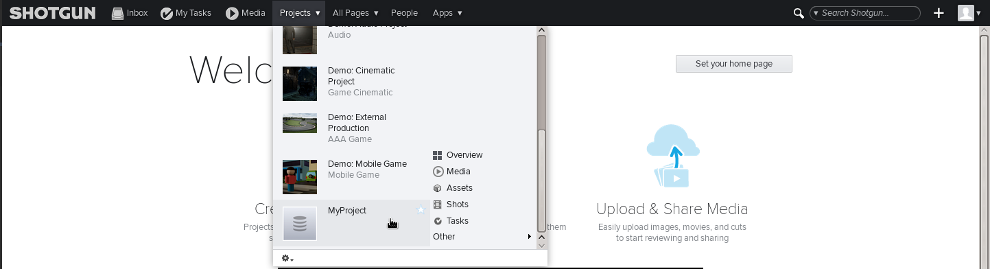

From the ShotGrid site, select the appropriate project from the Project tab.
This displays the selected media, with the comment and populates a window to insert a reply comment.

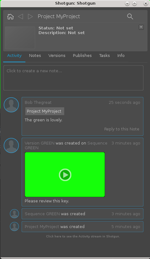

Back in Flame, a ShotGrid submenu appears in the Flame menu at the bottom right of the screen. This submenu contains:
To view the reply from the review request, select the ShotGrid Panel option. The ShotGrid Panel is displayed with the clip and all of the comments.
