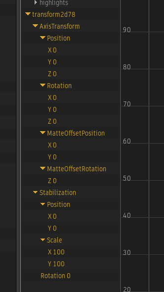

Improved Filters
The Name filtering criteria now also considers folder names. If a folder's name matches the filter, all its channels are selected in the channels list.
 | For example, a Name filter *tion matches the following folder names in a 2D Transform node: Under AxisTranform: - Position
- Rotation
- MatteOffsetPosition
- MatteOffsetRotation
Under Stabilization: Scale is selected even if doesn't match the *tion pattern. It is selected because the parent folder, Stabilization, does match the pattern. |

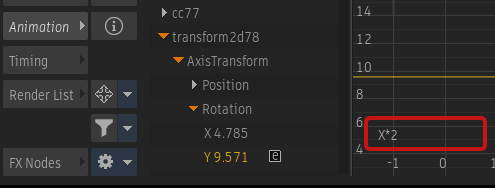

Link Channel Options
You now have access to new link options anywhere the Link Channel option is available.
Context menu
Link Special:
- Link and Negate Channel: Links to the channel, and add a minus sign at the start of the expression.
- Link and Add Channel: Links to the channel, asks for a number in the Calculator and then creates the expression:
channel+<number>
- Link and Subtract Channel: Links to the channel, asks for a number in the Calculator and then creates the expression:
channel-<number>
- Link and Multiply Channel: Links to the channel, asks for a number in the Calculator and then creates the expression:
channel*<number>
- Link and Divide Channel: Links to the channel, asks for a number in the Calculator and then creates the expression:
channel/<number>
