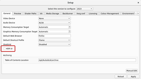

You can now set the Flame Family UI to HDR UI mode. In this mode, the display can use its full dynamic range to show HDR images, while showing the UI in the standard range.
To enable HDR mode:
Open Setup.
Autodesk
Setup
Applications folder
Autodesk folder
SetupIn Setup, select HDR UI.
Click Apply and close when done.
You Flame Family UI is now set to support HDR.

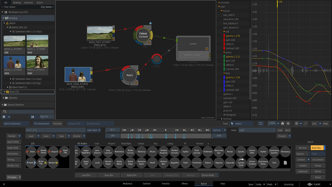

Flame, Flame Assist and Flare now have a new look. Highlights include:
A new font replaces the venerable Discreet font.
Buttons and schematic nodes are now flat.
The colour palette is updated and simplified.
The media tiles in the Media Panel and MediaHub:
Now have a larger text area.
Only display the scrub bar when the cursor hovers over.
