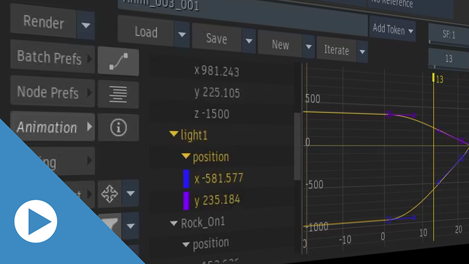

Animation Channel Editor
The UI of the Animation Channel Editor is overhauled to improve usability, implementing many improvements suggested by the community.
Indicates a feature suggested and voted up by users on the Flame Feedback portal.
Flame Learning Channel: Animation play list
User Interface Improvements
Some views change name:
- Channels is now Curves.
- Tracks is now Dope Sheet.
You now change between views with buttons
(Curves),
(Dope Sheet), and
(Info).
The name of the tab to the right of the Animation menu switches between Keyframe and Channel to match the current selection.
Channel list:
- Resize the Channel list by dragging the separator between the list and the curves or dope sheet canvas.
- The list uses the same look as other lists available throughout the application.
- A colour patch now appears left of the channel name when you assign a colour.
- Scroll with the scrollbar or Spacebar+drag.
- The cursor that shows where the selected channels are is now yellow and appears under the scrollbar.
- To collapse all items in the list, Alt+click Scene at the top of the list.
