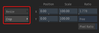

Redesigned Resize
The Resize tool now makes it obvious that you can use it to also crop an image.

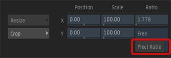

The Crop Box section has a new control, Pixel Ratio. It is only enabled when the Crop Box Ratio is set to Free.

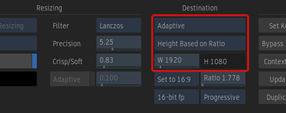

You can now set the Width and Height based on the Frame Aspect Ratio by selecting the Adaptive Mode in the Resolution menu.

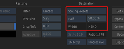

If you prefer to set Width and Height as a percentage of the source clip, select Scaling Preset from the Resolution menu.

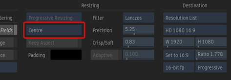

Centre and Filter: The Filter options can now also be set when the Centre resizing method is selected.
