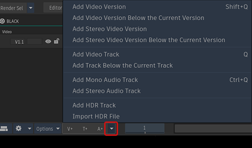

Timeline track options. The options to create the different type of tracks are accessible from a drop-down button attached to the V+, T+, and A+ cluster of buttons. More options have also been added to the New Tracks and Versions submenu available from the Tracks context menu.
Collapsible tracks. You can now collapse all Video or Audio tracks of a clip. This is done using the arrow icon present in the new section headers. Tracks that become hidden because their section is collapsed have all of their segments locked: no operations are performed on them even if they are part of a sync group with segments from another section.

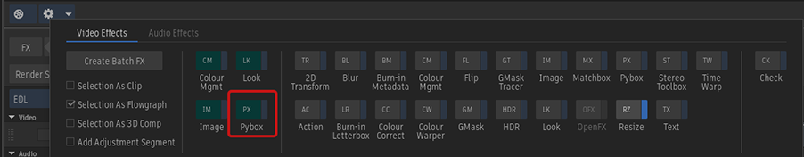

Pybox as Source Timeline FX: You can now use a Pybox as a Source Timeline FX. This makes it possible to load a FilmLight's BLG For Flame grade before the Timewarp and Resize Timeline FXs. Use it when you want to use the Resize FX to change the framing of your content without affecting the area where the Baselight colorist applied a shape-based secondary grading or a reposition.
To take full advantage of Source Pybox, make sure to apply the FX on a segment and not as a Gap FX. If segment uses a BFX or a Timewarp FX, you cannot render a Source Pybox using BLG For Flame.
