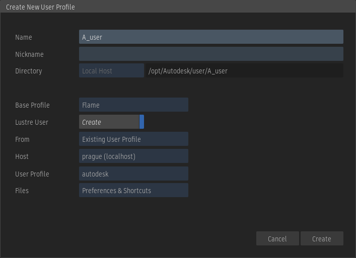

User Management Window Update
Here is a list of the changes to the User Management window:
- The Edit button is renamed Manage.
- The Reset button is removed from the Create User Profile window.
- The Modify User, Delete User, Reset User Settings drop-down button previously available in the Edit User window has been changed.
- The Reset User Settings is renamed Reset.
- The Modify, Delete, and Reset buttons are now always displayed.
The User Creation window displayed when you create a user also changes:
The new option Preferences Only is available in the Copy From setting. It allows you to copy the Preferences from an existing user without copying the keyboard shortcuts as well.
The Base Profile can no longer be changed in an existing user profile. The Base Profile button now indicates from which base profile the user was created rather than Current.
