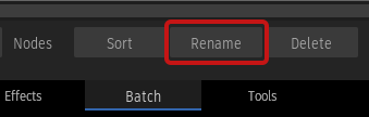

You can now rename a node in the Project, User, and Shared bins with the Rename button.

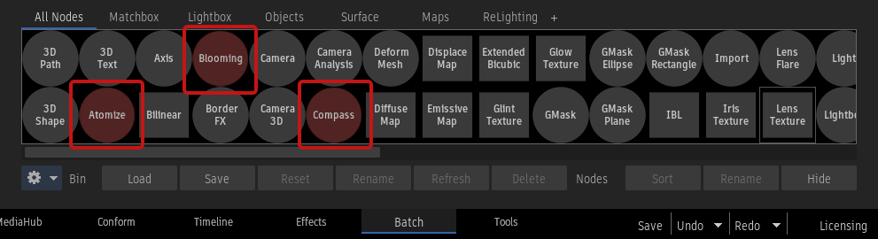

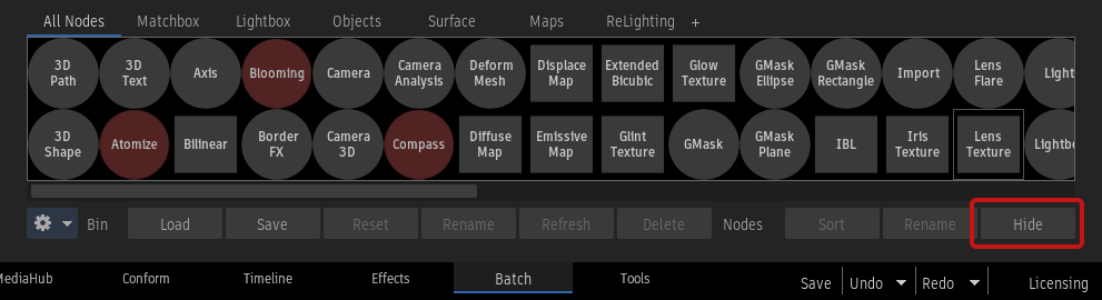

Nodes in the All Nodes bin of Batch, Batch FX, Modular Keyer, Action, GMask Tracer, and Image can now be hidden. This is done by selecting a node and clicking the Hide button located in the Nodes section below the bin.

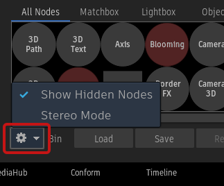

Hidden nodes can be hidden or shown with Bin Gear menu ()
Show Hidden Nodes.
Hidden nodes are shown in Red when their status is set to hidden but all nodes are visible.

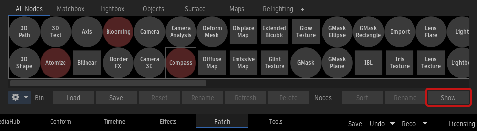

The hidden status of a node can be removed by selecting the node and pressing the Show button.
The Stereo Mode button has been moved to the Gear menu as well.
