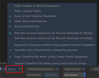

Filter out segments: Hidden and muted timeline segments can be filtered out from the List view using the Filter Hidden or Muted Segments setting located inside the Options drop-down button.
