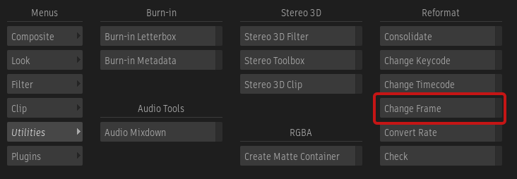

The file sequence index is now used to feed the Start Frame value. The Start Frame value for Movie and audio files is set to 1 by default. Clips and Pattern Browsing for file sequence now also support Start Frame from file index.

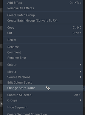

The default Start Frame for Movie and Audio Files is now set to 1. You change this value with Flame Tools Utilities Change Frame or context menu Reformat....
You can also use, in Timeline, Change Start Frame in the Timeline context menu.
