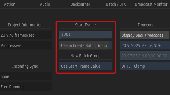

The Start Frame setting that was previously available in the Batch/BFX moves the General tab and becomes the default Start Frame value accessible throughout the application.
The Preference named Use in Create Batch Group option is now disabled by default. With this option disabled, when you create a Batch Group from the Conform environment or from the Timeline, the source media Start Frame is used as the Batch Start Frame. On the other hand, if Use in Create Batch Group is enabled, the Batch Group created uses the Start Frame value defined in the Preferences.
Note: If you use the context menu or the New button to create a Batch Group, the Start Frame is set to the Start Frame defined in the Preferences.

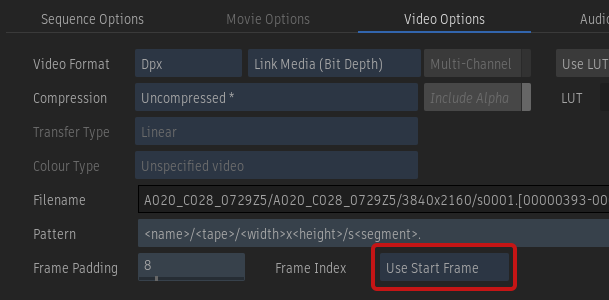

In the Media Export window, in Video Options, the Frame Index now contains more options to manage the Start Frame.

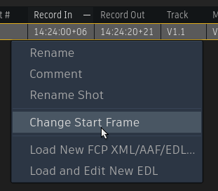

You can now change the Start Frame of a timeline segment with Segment context menu Change Start Frame. The new value is applied to the first visible frame of each selected segment.

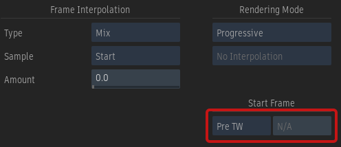

In Timewarp editor, there is a new Start Frame menu.
When using Connected Segments, a change to the Start Frame option of the Timewarp FX updates all the Connected Segments. To limit the scope of the Start Frame change, disable Use Segment Connections option.

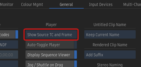

In Flame Preferences General Player Source Time Mode box , the new Show Source TC and Frame option displays both the timecode and frame value anywhere the source information appears. This is now the default option.

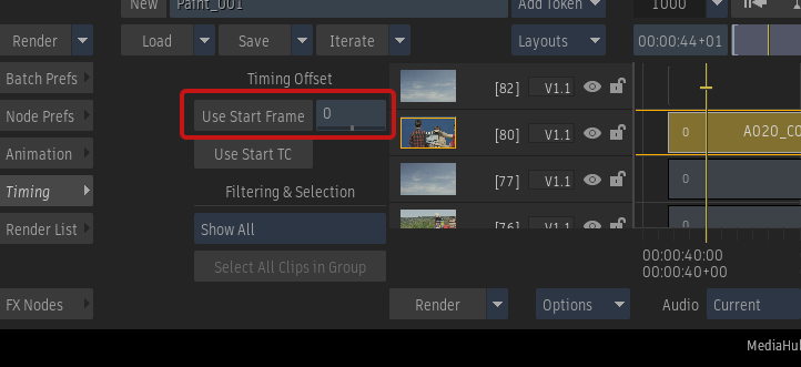

Using the Batch Timing view, you can align clips using their Start Frame with the Use Start Frame option instead of only relying on the timecode.

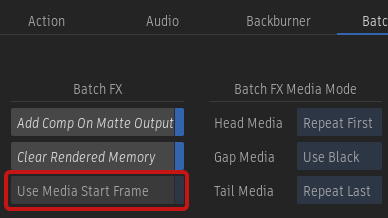

By default, when you apply a Batch FX to a segment, the Start Frame of that segment sets the BFX Start Frame. If you need your BFX to start at frame 1, disable Flame preferences Batch/BFX Batch FX Use Media Start Frame.

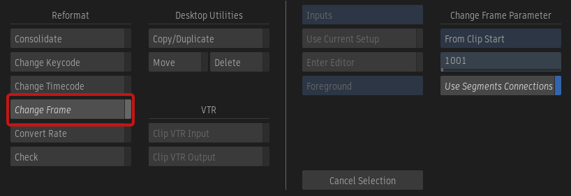

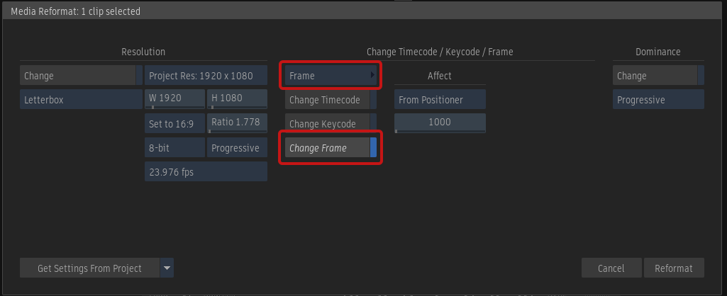

Clip Reformat and Change Frame tools
You can now use Clip Reformat and the new Change Frame tool to edit Start Frame of a clip.
The Change Frame tool is available in Tools tab Utilities Reformat.
Clip Reformat is available from a clip context menu and the Tools tab.
The Change Timecode tool can now affect the Start Frame, Update Start Frame. If you select Update Start Frame, changing the timecode also updates the Start Frame to match the new timecode.

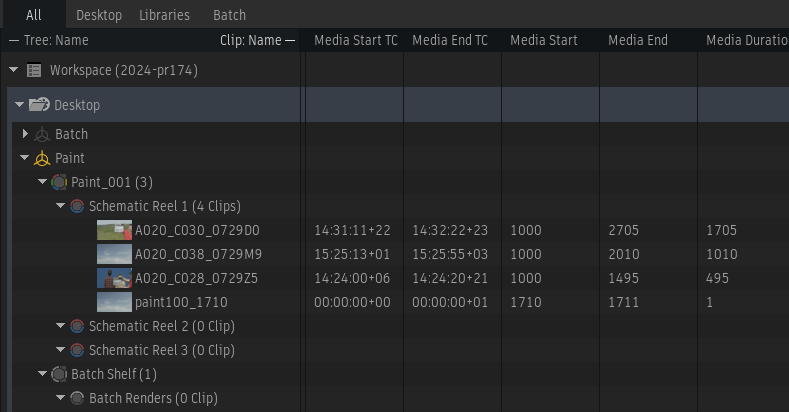

In the Media Panel, Conform, and MediaHub, the List views now displays both the Source TC and Source Frame information.

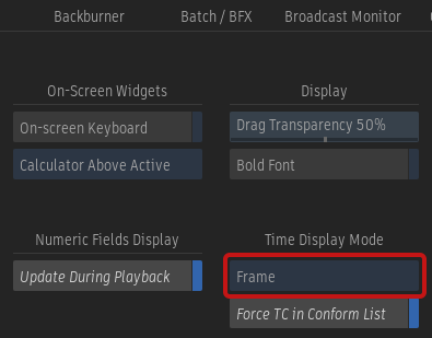

Flame Preferences User Interface Time Display Mode Time Display Mode box only affects the In and Out Marks, and Media Duration information.
List View with start and end timecodes, and frames values for media start, end, and duration

You can now change the Start Frame of selected timeline segments with Context Menu Change Start Frame.

Publishing Sources Sequences & Shots Sequence allows the connected from the connected sequences to use the published shots. When publishing, make sure to set the Frame Index in the Video Options tab of Media Export to Use Start Frame so that the published content uses the right Start Frame information.
