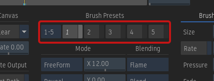

Brush Presets
The Brush Presets are now presented in the form of individual buttons rather than in a drop-down button.
The buttons are now located below the Mode and Blending sections. Only five buttons are presented at once. A button can be used to toggle the display between the presets 1 to 5 or 6 to 10.

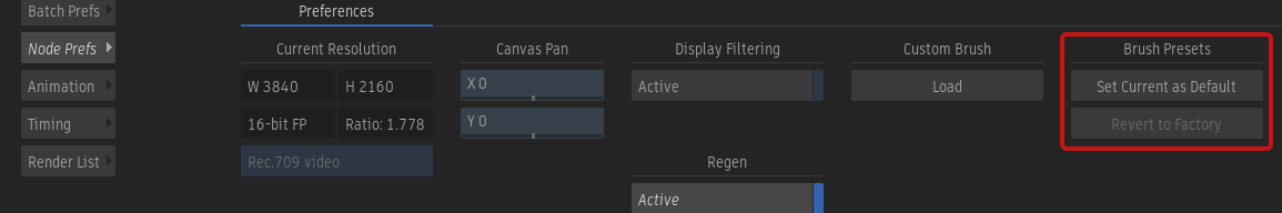

Set default presets. You can save a default Brush Presets and define it as the default for all newly created Batch Paint nodes.
To create a default set:
  1. Set the default using Node Prefs Brush Preset Set Current as Default. This option creates the default from the current Brush Presets.
To restore the original Brush Presets, use Node Prefs Brush Preset Revert to Factory.

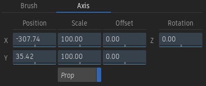

Edit strokes in the UI. You can now use the user interface change the Position, Scaling, and Rotation of the primary stroke (the stroke with the Edit Box). The buttons are in the new Axis tab and make it easier to set and reset animation keyframes.

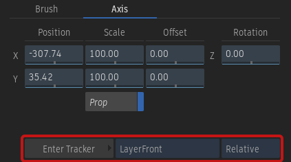

Track Strokes
You can now track strokes using the Tracker tool in the Axis tab.
  1. In the Edit list, select the strokes that will follow the track.
  2. Click Axis to display the Tracker tool.
  3. From the drop-down menu, select the layer to track. This can be the Front of the clip (LayerFront), or any other source attached to the Paint node.
  4. Click Enter Tracker to enter the Tracker module.
  5. Track the shot. Exit the Tracker module when done.
    Back in the Paint node, the track is applied to the strokes.
After the track, use Offset X and Offset Y to offset the strokes without affecting the position information gathered from the Tracker.
Note: The X and Y Position settings of the source used for a Reveal inherit the same tracking offset as the strokes. This makes sure the reveal strokes and the source are synchronized.
Track by absolute or relative position. Before entering the Tracker, you can select how the tracking data is applied to the selected strokes.

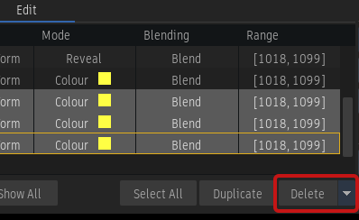

Clear Strokes
In Edit mode, the Delete drop-down box easily deletes the selected strokes at a specific frame, or deletes the selected strokes in their entirety.

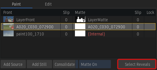

Reveal Strokes
You can now easily identify the Reveal strokes associated with a layer (the strokes that reveal that layer).
To select the Reveal strokes associated with a layer:
  1. Select the layer.
  2. Click Select Reveals.
    The Edit tab is selected, with the Reveal strokes that were made with the selected layer.
The Select Strokes button has been renamed to Select Reveals and is now enabled only when there is at least one Reveal stroke associated to the selected source.

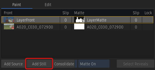

Add Still
The new Add Still button creates a new single frame source from the image shown in the selected viewport.
A new clip is created in the Batch Schematic and is connected to the Paint node with a new Source node.
Tip: Use Contexts to create stills from other nodes.
