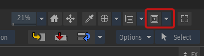

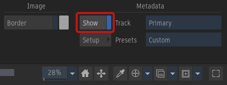

Display the Metadata Overlay using:

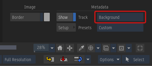

In the Player, you can select the source of the displayed information. This source is either the Primary or the Background track (the lowest track in the timeline). You can set this in the Metadata Overlay Edit Setup, or in the Overlays menu, with the Track box.

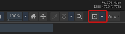

Overlay button. You now display or hide Overlays using the Overlay button. Use the Overlay drop-down to select a preset or edit the overlay.
Overlay button in the Player
Overlay button in Batch
