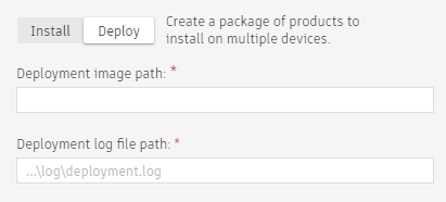

The default standalone installation has predefined options which are not selected during installation. If you need to change the default options, install multiple products at one time, or install on multiple devices, then you need to use the Custom Install option on your Autodesk Account.
The options for a custom standalone installation and a deployment are the same. Once the install options are selected, you decide if you want to create a standalone installation or a deployment.
Choose Install if you are only installing for yourself.
Choose Deploy when you need to install the products on multiple devices.
