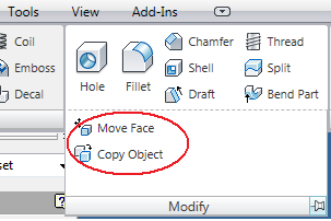

SlideoutControls Property that returns the CommandControls collection object that provides access to all controls in the slideout section of the panel.
SlideOutKeyTip Gets and sets the keyboard access key for the slideout controls within the panel.
