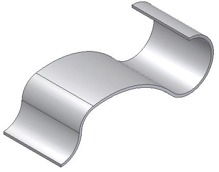

For most models the Face specified in the StationaryFace parameter must be on the top or bottom of the part, not around the edge. The exception to this is a part where all of the faces on the top and bottom of the part are cylindrical, as shown below.

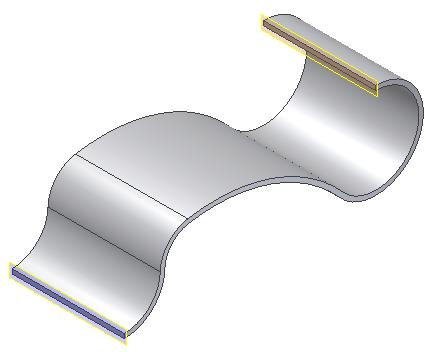

When using the Refold command in the user interface for parts like this, the user must specify one of the ends. The user interface displays what looks like work planes at each end of the part, as shown below, for the user to select. When using the API you must supply the equivalent Face objects at the end of the part.
