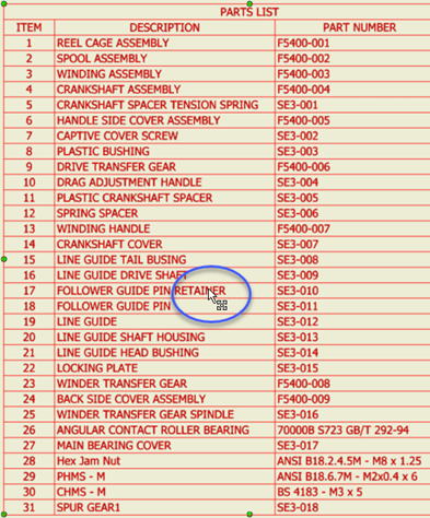

The following example shows how to split a parts list and then move the new segment to a different sheet.
  1. Move your mouse over text in the table row where you want to make the split. Right-click when the move icon appears.
  2. Click Table Split Table in the context menu.
    The table splits into two segments. In the browser, the new table segment displays as a child of the parent table.
    Tip: To stitch the table back together, right-click a table segment in the display or browser and click Un-split Table. All segments are connected to the parent table.

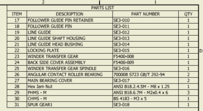

  3. To move the split section to a new sheet:
    • Expand PARTS LIST in the browser.
    • Drag the split table to the area just below the new sheet label.
  4. Double-click the new sheet in the browser to make it active and adjust the split table location.
