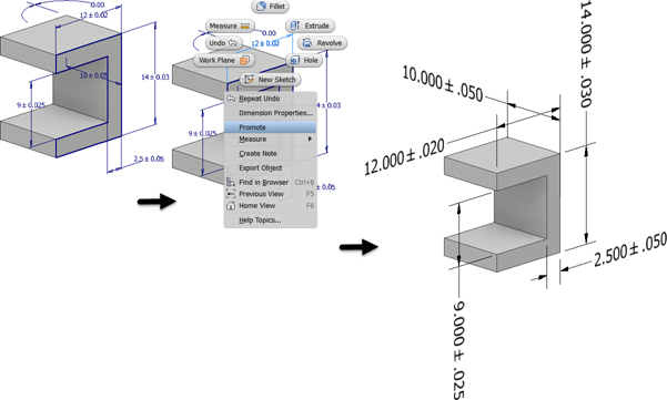

Extract existing dimensions
To include existing dimensions in the model-based definition:
  1. Right-click a feature in the browser and select Show Dimensions.
  2. Click any visible dimension and select Promote in the context menu to create a 3D annotation.
    If the model dimension includes tolerance information, it is included in the promoted dimension.
If you edit the promoted 3D annotation, check Synchronize parameters tolerance to apply tolerance changes to the sketch dimension. Clear the check to change the 3D annotation tolerance without changing the sketch dimension.

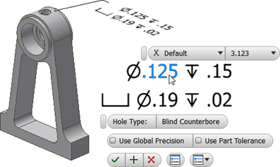

Add or edit hole/thread notes
Holes and threads annotated by a hole/thread note cross-highlight when you select the leader or the browser node.
  1. On the ribbon, click Annotate tab General Annotation panel Hole/Thread Note .
  2. Select the hole feature.
  3. Optionally, do any of the following and then click to place the hole note:
    • Click Align to Geometry in the context menu and then select an edge or axis to orient the text.
    • Click Change Annotation Plane in the context menu, or use the SHIFT shortcut key, and then select an alternate annotation plane.
    • Click Change to Next Candidate Plane in the context menu or use the SPACEBAR shortcut to cycle through alternate planes.
  4. Optionally, do any of the following:
    • Enable the Use Global Precision checkbox or clear the checkbox and then click a drop-list value to change the precision.
    • Enable the Use Part Tolerance checkbox or clear the checkbox and then click a drop-list value to change the tolerance.
    • To access more options, click Edit Hole Note in the minitoolbar to display the dialog box and then make any required changes.
  5. Click OK to add the hole/thread note.

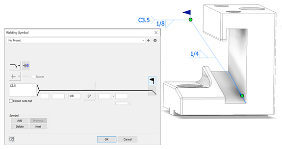

Add or edit welding symbols
  1. On the ribbon, click Annotate tab General Annotation panel Welding Symbol
  2. Select the geometry where you want the weld symbol to anchor.
    • If an edge, after placement, you can move the anchor point along the edge to adjust its position.
    • If a face, after placement, you can move the anchor anywhere within the face boundary.
  3. During preview, use the following to change the annotation plane (Shift) and alignment (Tab).
  4. Click to position the leader.
  5. Right-click and click Continue to define the weld symbol.
  6. In the Welding Symbol dialog, set the features you want represented by the symbol.
  7. Optionally, to include subwelds use these Symbol options:
    • Add, extends the leader and adds a secondary symbol set.
    • Delete, removes the current symbol set whether primary, secondary, or other.
    • Next, makes the next symbol in the group active for editing or deleting.
    • Previous, makes the previous symbol in the group active for editing or deleting.
