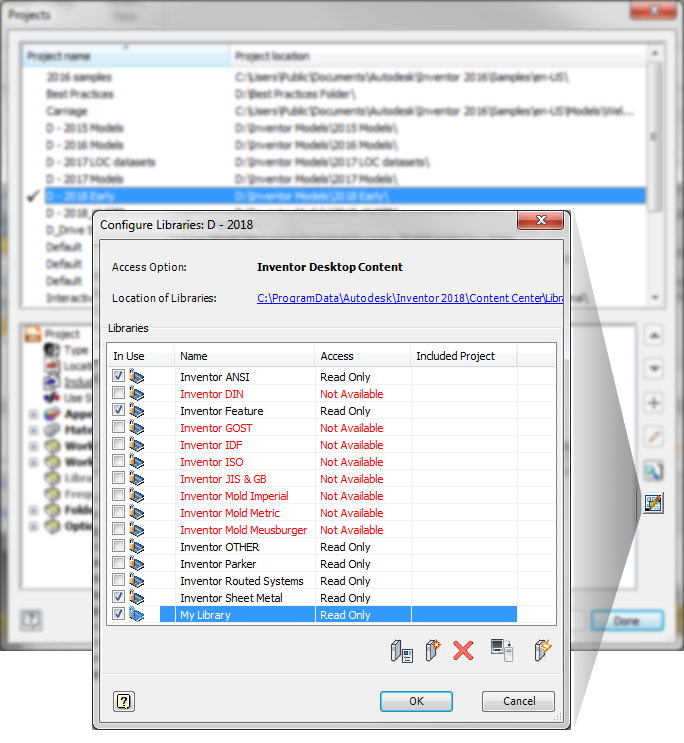

Inventor Content Center database contains over 750,000 parts and covers 18 international standards. Considering your design requirement, only loading necessary library will boost your speed to load Content Center and place from it.
If you only use small portion of library content, consider copying your required families to the custom library, then only load it in your project setting.
