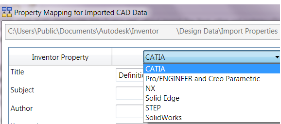

  2. In the Property Mapping for Imported CAD Data dialog box, click the drop down menu and select the format you want to map the Inventor standard properties to. When the Property Mapping tool is launched from the Import dialog box, the format automatically defaults to the format of the file you are importing.
