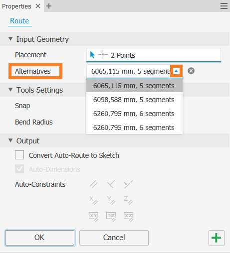

To switch to alternative auto route solutions
  Once terminal geometry is defined to create an auto route region, there may be multiple solutions calculated based on length and number of segments. To display the available alternative during route creation, click the Alternatives drop-down arrow.
  Note:  You can also use the Select Other command to cycle through all the available solutions.
  - Activate the route.
- Right-click the Autoroute browser node or an auto route segment in the graphics window, and select Alternate Route Solution.
- Use the Select Other command to navigate to the desired solution and click the green area to set the selection.
- Right-click in the graphics window and select Finish Edit.
