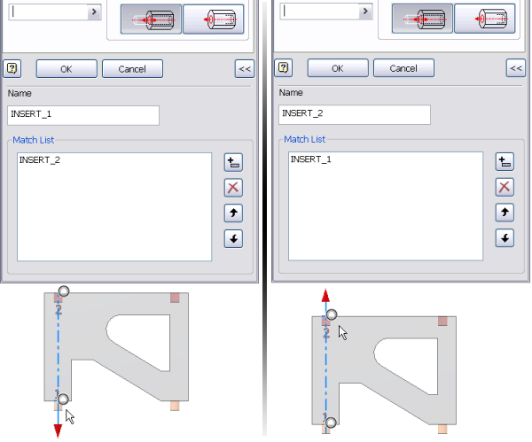

In this example, multiple instances of a component are assembled in ladder form. To accomplish it, an iMate matching list is created so Post 1 is always placed into Hole 2.
  1. Create an iMate insert constraint named Insert_1 on Post 1. Expand the dialog box and create the preferred match (Insert_2) as the first entry in the matching list.
  2. Create an iMate insert constraint named Insert_2 on Hole 2. Expand the dialog box and create the preferred match (Insert_1) as the first entry in the matching list.
  3. Place the first instance of the component into an assembly.
  4. Place the second instance of the component using the Place Component dialog box. Enable either iMate option (Interactively place with iMates, or Automatically generate iMates on place).
Note: To constrain fully on placement, follow these steps to create Insert_3 and Insert_4 on the remaining features.
