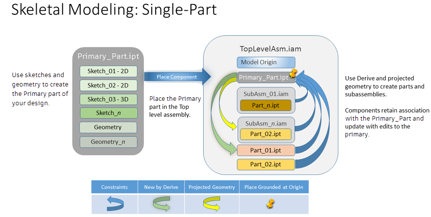

The Single-Level Process uses a single primary part containing sketches and geometry that represents the final design. The primary part is placed in the top-level assembly. All components (parts and subassemblies) are created relative to the primary part. Downstream, modifications to the primary part drive changes in the components associated to the primary part.

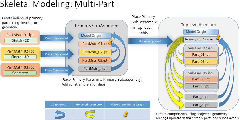

The Multi-Level Process uses individual primary parts comprised of sketches to represent the final assembly. The primary parts are placed and constrained in a primary sub-assembly. The primary sub-assembly is placed in the Top-level assembly. Inside the Top-level assembly, the individual 3D components are modeled using projected geometry from the primary sub-assembly and its primary parts. The 3D components can be contained in logical sub-assemblies or separate, according to the design requirements.

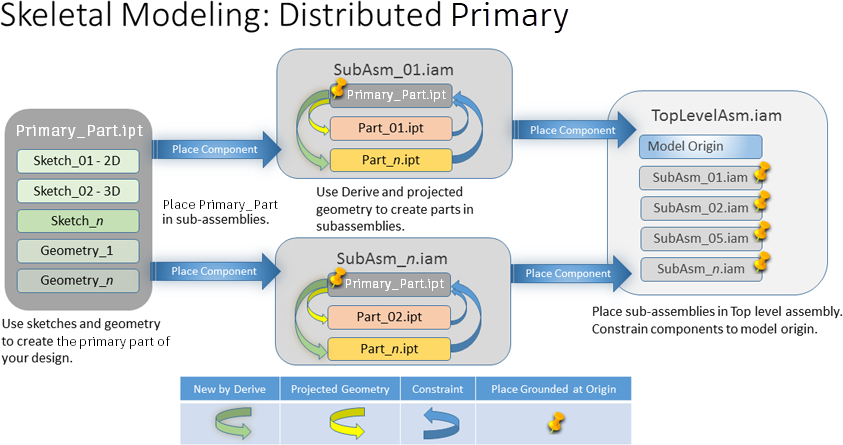

The Distributed Primary uses a single primary part, comprised of sketches and geometry, to define the final assembly. The Primary Part is referenced in the various sub-assemblies and parts as needed. The Primary Part controls the overall layout. The assembly and sub-assemblies are defined or placed with respect to the Primary Part. Each sub-assembly has its own skeleton and drive a portion of the design within itself. Higher level skeletons are used to drive the overall layout or mechanism of the assembly while lower level skeletons can be used to drive the geometry of the parts.

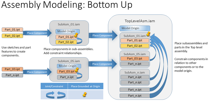

Bottom-up
Bottom Up is the traditional way of building assemblies. First, you define the different parts. Then, you put them into sub-assemblies using assembly constraints. The sub-assemblies are then placed into higher lever assemblies up to the top level assembly and in this way, you are working your way from the bottom up. This assembly method results in assemblies with a number of relationships between parts and assemblies.
This approach can lead to two things:
  1. It can consume system resources and slow down performance.
  2. Model changes ripple through the design due to a lot of cross references and/or referenced geometry that are affected.
This diagram is provided as a comparison to the skeletal modeling methods mentioned above.

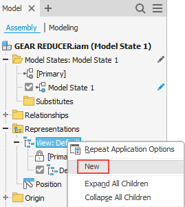

View Representation
View representations (view reps) store a component's current state when the view is created, edited, and then, saved. The saved view representation preserves component visibility, transparency, sketch visibility, work feature visibility, selection status, and camera state, magnification, viewing angle, and part view representations. View Representations load a component only once. Changing between view representations does not unload or reload components.
Use view representations to control the number components visible at a given time. View representations improve both assembly performance and capacity. Add standard view representations to your templates and configure these for each assembly.
To create view representations:
  1. In the Assembly model browser, expand Representations and right-click View and in the context menu, select New.
  2. Next, hide or modify components or scene aspects.
    Tip: Use the tools in the QAT (Quick Access Toolbar), or in the graphics area, hold "Shift" and right-click to bring up the Selection Filters. To easily select all occurrences of the same component (Select All Occurrences) or all internal parts (Select Internal Components), make use of the appropriate selection option.
  3. When the content of a view representation matches your intent, Save the document to preserve the representation. If you do not save it, the states will not be preserved.
