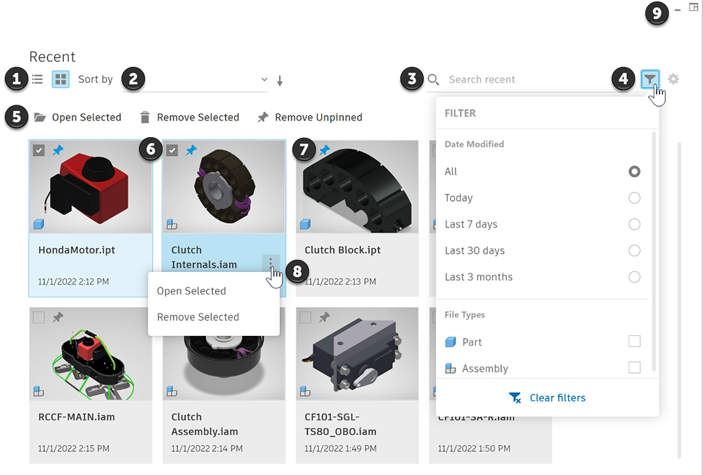

Recent Documents
Use this panel to manage your recently opened documents. This panel also displays the status of files managed by a Vault project.
Tip: You can set the maximum number of recent documents to display, up to a maximum of 199, in Application Options General tab Home pane.
  1. Toggle between list view and thumbnail view. Thumbnails display for local or cloud based projects.
  2. Click the drop-down to sort by Date Modified, Name, Location, or iProperties. Click the arrow to sort in ascending or descending order. In List view, click the column header to sort. The default for sorting is the Last Opened date.
  3. Click in the Search box and begin entering text or numbers. The Recent list continually refines as you enter information. The Search criteria is cleared when you change Projects, click the Clear button (focus remains with search box), or use ESC (focus remains with search box).
    • Search includes file extensions. For example, searching on 'ipt' would return all files with 'ipt' in the file name as well as all part (.ipt) files.
    • Search supports using Name, Location, and IProperties.
  4. Click the Filter to further narrow the Recent list. Limit the filter using Date Modified and file types. The Filter icon badge show how many file types are included in the filter and the File Types section lists the types displaying as a result of the filter. If you are using Vault, you can filter by the various file statuses.
    Note: When switching to a vaulted project, you will need to refresh the vault status.
    Clear Filters resets all filters to their default values and all recent files display in the list.
    Click away from filter panel to close it.
  5. If no files are selected, the option Remove Unpinned displays. With one or more files selected, the options are Open Selected, Remove Selected, or Remove Unpinned.
  6. Click the check box to select a file, multi-select is supported. In Grid view, Ctrl+click and Shift+click are not supported.
  7. Click the Pin to keep a document pinned to the top of the list.
  8. Double-click a file to open it or click the ellipsis to access these options:
    For single selection
    • Open - opens the selected file.
    • Open with options - select the Model State, Design View, and Position View to open with. You can skip unresolved files.
    • Remove from Recent - removes the file card from the Recent list.
    • Open containing folder - opens folder with the Open dialog. You can use this to quickly locate other files in the same folder as the selected component.
    • Explore containing folder - opens an Explorer window for that folder. You can use this to quickly locate other files in the same or neighboring folder as the selected component.
    • iProperties - the following conditions apply to the properties list.
      • Document is not open - Displays the Explorer Properties dialog. Click the iProperties tab to access Explorer version of iProperties. For model state documents, properties for the primary model state display.
      • Document is open - Displays the Inventor iProperties dialog, including Physical properties. For model state documents, properties for the active model state display, not the properties for the one shown in the Recent list.
      • Vault Properties - Vault properties are available ONLY if:
        • The active project is a Vault project.
        • Vault add-ins are loaded.
        • The current user is logged into Vault.
      • User-defined properties are supported.
      For multi-selections
    • Open Selected
    • Remove Selected

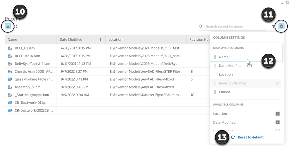

  9. Click these controls to minimize the window or to restore the previous view layout.
  1. Click List View to see models in a configurable table.
  2. Click the Configuration button to access the column setting and content. Name and Pinned are permanent columns. You can add columns that display iProperties values. Configuration is only available in the List View.
  3. Reorder the columns using drag and drop.
  4. Use the Reset to default to clear modifications made to the column order and content.
