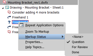

The Markups browser displays the markup set in the tree view. Once you have reviewed markups, you can change their status and add comments that are saved with the markup. In the Markups browser, you can right-click a markup to change the markup status and display the Markups Properties dialog box.

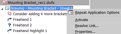

To display the Markups browser and add notes: Right-click a markup node and select Properties from the context menu to display Markup Properties dialog box. Add notes to the Markup Notes area.
To find all sheets in the IDW file: Right-click drawing file in the browser and select Resolve Link.
To save changes to markups: Right-click the DWF root node, and click Save Markup History Changes.
