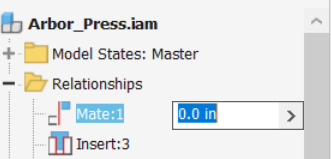

Edit Values in Browser turns the display of the browser edit box off or on. If enabled, the browser edit box (used for changing or measuring constraint geometry) displays near the item to edit.

Relationships display a sequential list of all joints and constraints in the assembly. You can quickly change or measure constraint geometry by selecting an item in the Relationships folder. The Edit Values in Browser browser menu option must be enabled.

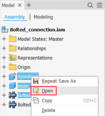

The context menu (right click) presents operations on the selected component, feature, or relationship in the browser. Depending on the browser configuration and the selected item, some or all options are available.
The context menu and viewing options are available when you right-click an item in the graphics window or in the browser.
If you use Copy Component on a part file with model states, the file has not been saved to disk when you use the context menu Open. A dialog box prompts you to save before you can open.
You can select multiple components and sub-assemblies from the browser and open the selection set in separate sessions. Right-click the selection set and click Open.
