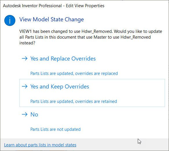

About parts lists in model states
A parts list references a model state and can be shared on multiple sheets. When you edit a view and change the source model state, parts lists referencing the original view model state are affected.
An information box is presented so you can decide how to resolve the parts lists.
- Yes and Replace Overrides Select this option if you want the parts lists to reference the new model state BOM and discard existing override values.
- Yes and Keep Overrides Select this option if you want the parts lists to reference the new model state BOM and continue to use existing overrides.
- No Select this option if you do not want to change the parts lists.
