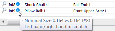

    • Detailed information about the 4 types of mismatched thread interferences. Hover over the information tooltip to display the type of interference.
      • Threaded components are misaligned.
      • Thread designation doesn't match, including nominal diameter, pitch .
      • Left/Right hand doesn't match.
      • Thread depth mismatch indicates the external thread length and the internal thread depth do not satisfy the minimum thread engagement.
        For example, interference is reported when the length of a component's external thread is shorter than the depth of the internal thread. The following illustration represents another example where minimum thread engagement is not met.
      Note: The first set of numbers in the tooltip indicate Internal thread value. The second set indicate the External thread value.

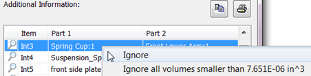

    • Ignore and Un-ignore options. You can:
      • Right-click an item and select to ignore the selected volume or ignore all interference volumes less than a selected value.
      • Select or deselect the Ignored filter to show or hide the ignored interferences in the list.
        Note: An ignored interference is displayed with a cross line.
      • Right-click an ignored interference and select to Un-ignore the selected item, or Un-ignore all.
