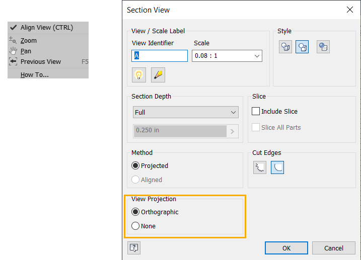

Override Section View Alignment During Placement
When creating a section view, by default, the view is aligned with the parent view. You can use any of the following methods to enable/disable alignment with the orthographic projection from the base view. When you disable alignment, you can align the section view with any other view because it is no longer aligned to the parent view.
  1. Create the section view, but do not click to place it.
  2. As you drag the section view away from the parent view, use one of the following methods to disable alignment:
    • Context menu
      Right-click in the graphics window. and deselect Align View.
    • Section View dialog box
      Under View Projection, select None.
    • Hold down the CTRL key
      Click to place the section view where you want it and then release the CTRL key.

  4. (Optional) Specify the appearance of the view in the Section View dialog box.
    • For a section view defined by sketch geometry:
      1. Edit the View Identifier and select the Scale.
      2. Select the Toggle Label Visibility icon to change the label visibility.
      3. Click Edit View Label to edit the view label in the Format Text dialog.
      4. Set the display Style and Section Depth for the view.
      5. Specify whether the Method of the section view is projected or aligned.
      6. Select the desired Cut Edges to display Jagged or Smooth cut lines in the section view.
